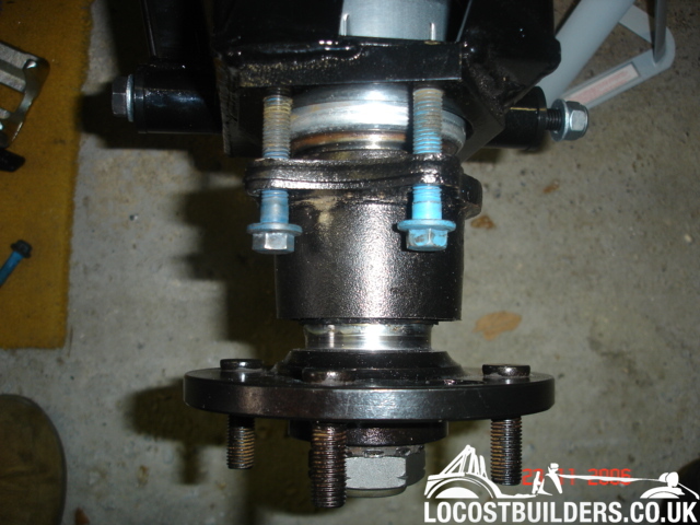

I'm just fitting my hub carrier and drive flange to the driveshaft and notice a gap of about half an inch between the drive flange and the hub
carrier and also a gap of about an inch (and a half) between the hub carrier and the upright.
If I tighten the bolts that hold the hub carrier to the upright, I'm sure the CV joints will compress a little, but is that the right way to take
up the slack?
Also the gap between the drive flange and hub carrier: can I just tighten the hub nut to bring it all together or did I not put it on right?

As stuart says. The hubs will push the driveshaft back and compress the CV joints.
Have fun doing the hub nut up
P.S. to tell which is the right drive shaft:
Drivers Side one should be a right hand thread (tighten clockwise)
Passenger side one will be left hand thread (tighten anticlockwise)

.and one driveshaft is slightly longer that the other too............

Thanks for the responses, guys. I try to do some homework on the forum archives before I ask silly questions, but wasn' t sure about this
one.
I've now verified my shafts are on the correct side. Check. My parts are not from an ABS car, so no need to take off the teeth. Check.
Made sure I know which way the hub nut is supposed to be tightened (hand tightened them first). Check!
So I guess I'll be allright. Time to start tightening! Oh I just know those hub nuts are going to be b****rds!
