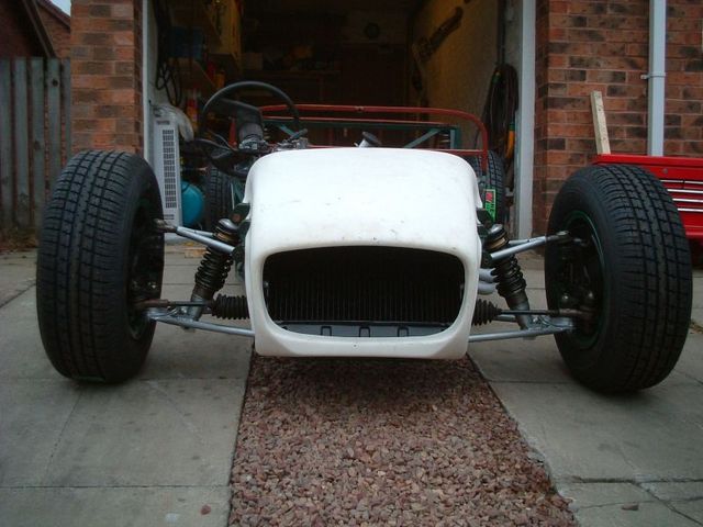

Ian, your steering wheel is not fixed sticking that far out to the side is it?

RichardK
| posted on 2/12/06 at 05:24 PM |
Haven't seen front lower wishbones like them before with the coilover mounting bracket underneath, where are they from?
Just been nosey

lexi
| posted on 2/12/06 at 06:34 PM |
Methinks they are built to accomadate a nice long pair of coilovers?

ianclark1275
| posted on 5/12/06 at 04:01 PM |
Paul, No steering wheel is not fixed, actually got rid of the escort one and used the sierra column.
Richard, The lower wishbones came with the struts as a job lot. (second hand)

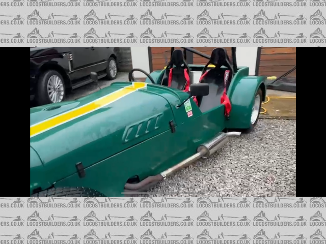

| posted on 19/1/25 at 10:18 PM |
Hi fellow builders
Thanks for the advice
Getting closer to IVA....its taken longer than expected lol
Just a few question to see what you can recommend..
1. Dashboards - anyone go Carbon ? and does it have the radius required at the bottom ?
2. Rear arches - do they need rubber edging on them?
3. seats (MK) do they need rubber edging all round then not just in seat belt holes?
4. Moveable seat runners - Long legs (Me) and short legs (Dad) 2 lock positions - is that ok?
5. Brake master cylinder - does it need additional steel plate in bulkhead ie doubled up ?
6. Centre rear view mirror ? as well as side mirrors (we are non windscreen)
7. Decent set of compliant dash switches - BMW mini ?
Also
VIN Pack - We are using MK2 Escort - do you apply to DVLA and get a Chassis number sent back and then put the plate on and the chassis stamped
(welded plate) ? Then apply for IVA?
Car in York so will take it to Beverley i recon.

18 years later lol. At least you've not quit in that time!
ianclark1275
| posted on 19/1/25 at 10:27 PM |
Honestly, you need the Dunkirk Spirit sometimes lol
I recall dropping into the lads at Maltby and getting bits welded and it was all exciting etc
its go to be the final push this summer.
We have done Donnington Track day in 2023 and Cadwell Park in 2024 (first high speed run) for shakedowns which were very useful
Just needs last bits doing
measure twice, cut once, scrap it, start again.
