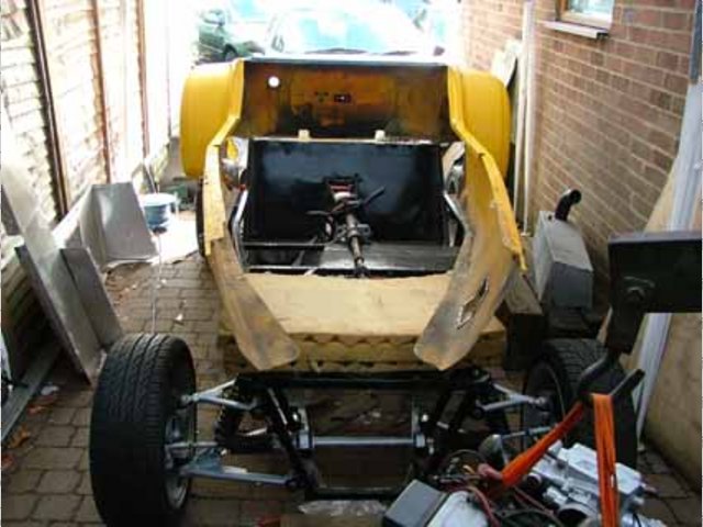

Thanks for the replies I don’t know what the current springs but it sits on on the bump stops at the moment.
“Did you have much trouble getting the Westfield bodywork to fit?”
No it was much easier than I thought I was thinking I would have to hack it up an narrow it as it is a wide body but it just slipped on with only some
minor cutting around the inside of the sill that runs up to the roll bar base. I am going to have to widen the arches as the car has I think a cortena
rear axle so the rear wheels stick out about 1”

here is a pic of fitting the body

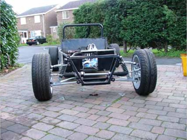

O yes I forgot I had to chop the back off the chase and shorten it about ¾”

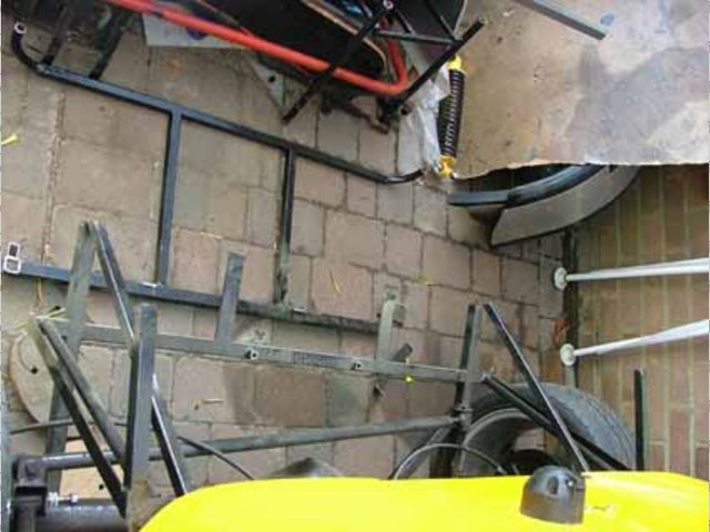

Here is the best pic I have at the mo of the suspension

Hi the angle of the dampers looks to be not to bad about 30-35 degs. However you have a wishbone desighn with the damper lower bracket quite a long
way from the bottom ball joint/wheel so i would guess that at least 300lb would be needed.

Thanks for the help I will take the spring off tonight and see if I can see the load marked on the top and get back to you. The wishbones are slightly
different to the book here is a link http://www.rallydesign.co.uk/catalog/product_info.php?products_id=11835 If you whant to have a closer look
