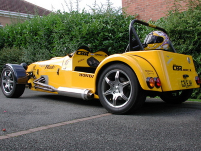

alanr
| posted on 19/12/06 at 03:49 PM |
just a couple of times and I just drive sensibly - no fast cornering and no flooring it
wheels are TSW

Furious D
| posted on 19/12/06 at 03:52 PM |
They look nice mate.
