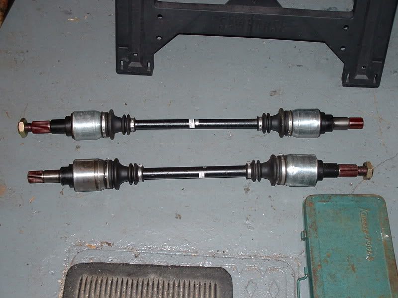

OK Ive got the drive shafts out. Looks like the inner gaiter on the left has slight cracks in it (not fully through) but the outer gaiter looks like it may have a hole (looks a bit greasy).
The questions are:
Is it worth replacing the gaiters?
If so does this mean a complete strip down of the drive shaft or at least one end to replace a CV joint?
The haynes book of lies is pretty much useless for this. It says chop through the metal foil cover over the joints catching the spring that shoots out then replace the bits for reassembly.
Anyone know the sort of price for the bits to re-assemble one of the CV joints? I presume the gaiters are about a fiver each?
Forgot to add its a rear drum car. Looks like the wheel side gaiter is fucked.
Anyone know a decent place to either a) get it overhauld or b) get the parts to do it?

Replacement Gaiters
I've just done all four of mine - was quoted about a tenner each, but when I showed up in person I was only charged £8 each so £32 in total, they obviously come as mini-kits (gaiter two stainless bands and grease).
I asked about glue together ones to make it easier, but was told these ones would stretch over... Well, they did, but hoof! what a pain - immersed in boiling water for five mins each, and with the shaft in a vice and giving them everything I had I managed to get them over the lip, then a second pair of hands pulled them rest of way...
I'd do it again, but only one at a time - it really was a pain in the bum...
HTH all the best!

Take the driveshafts off. I you then push the joint down the shaft a little you will see it is only held on by a circlip.
Take the circlip off and you can them remove the joint. Changing the gaiters is then very easy.
Be careful with the joint though as if you're not careful it will spin round and the bearings will come out. Not a drama but a bit of a pain getting them back in.
It is common to put the joints back on the opposite end of the shaft so any wear will be on the back of the cups so does not give a sloppy feel when pulling away.
CV grease. Don't you just love it.....

OK, I'll have a looksee. The Haynes manual is a bit vague but it seems to be that you need to undo the 41mm hub nut to get the drive saft off the hub. Then its a new nut on replacement. That right? Seems a bit excessive I would have thought it would be a spline push fit like the diff end. But Oh well, time to blag an air impact tool and then resign myself to using an angle grinder on the resultant rounded off nut
Thats an interesting poitn about the sloppy feel pulling away. The whole car used to judder pulling away in first but was fine under normal use. I thought it may be the clutch, but with the leaking gaiter it (it was more like oil that grease) it may well be a knackered CV joint too.
