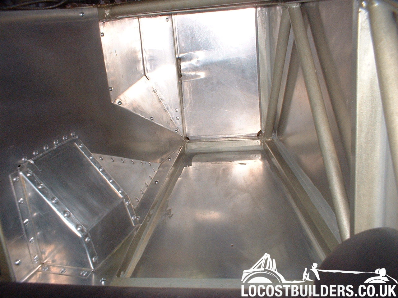

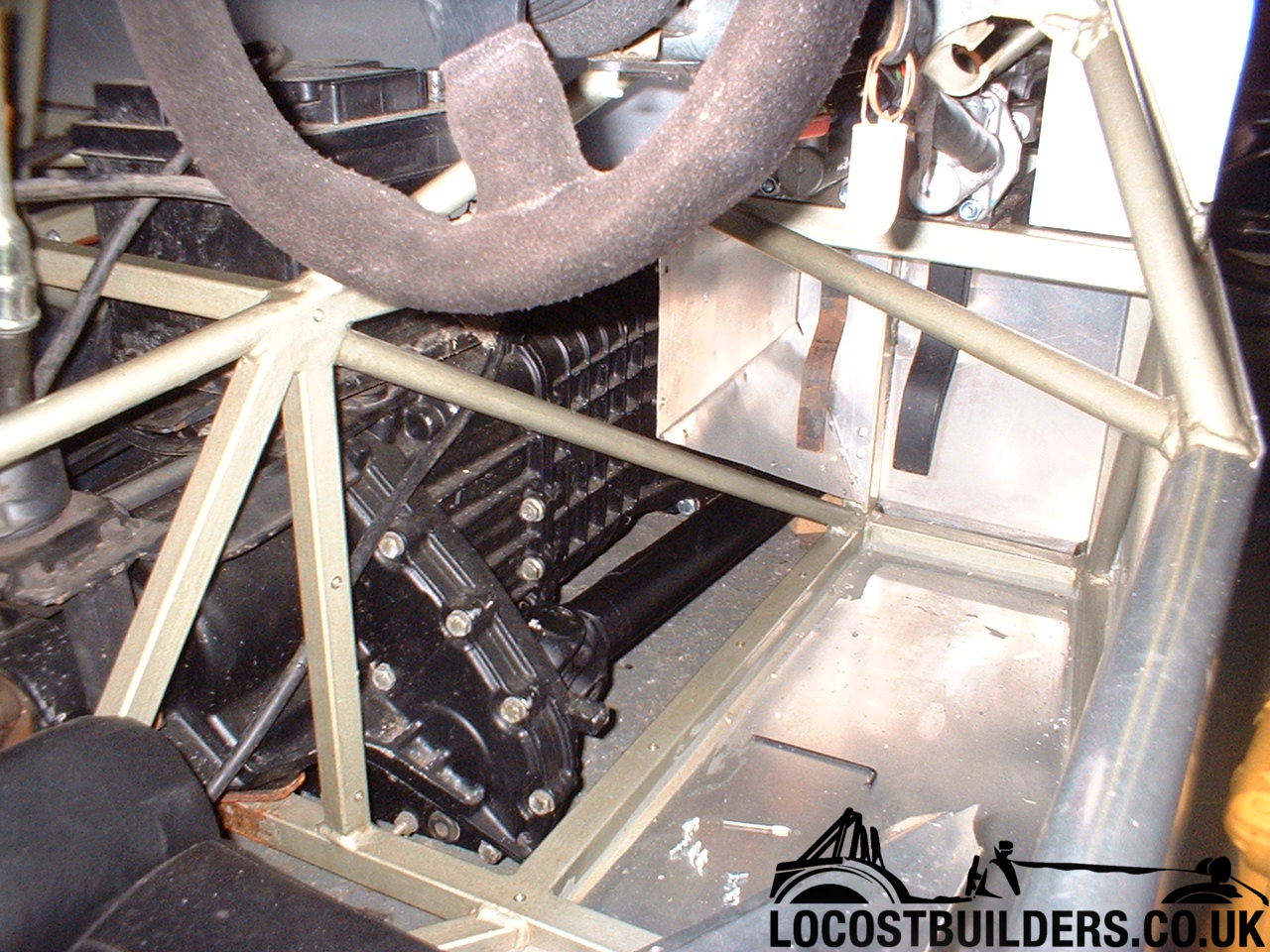

More room in my footwell than in a Dax due to their tapering cabin sides. The front prop runs at about floor level so doesn't really get in the way, and the bulge for the transfer case is under your knee so not even noticed.
My footwell bottom tube makes quite a narrow looking footwell because it has to give room for the front prop, but i've bulged the footwell panel out into the tunnel to give plenty of room. Could have given myself a lot more but being obsessed with triangulation and stiffness I just had to put in the diagonal in the inside of the footwell . My pedal spacing is the same as a lotus elise.
Have a look at these from my photo archive...
Front Prop
Panel Fitted
Snugger than some but you only need enough room to use the pedals!
