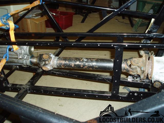

I've shortened a number of propshafts and I've never had a problem and never needed one to be balanced. You do however need access to a lathe. First mark the relative positions of the UJs by scribing and be very careful to reassemble in the correct position. The front UJ is on a spigot which slides inside the tube. You can cut the tube beyond the weld and remove the UJ. The weld and residual tube can be turned off and cleaned up on the lathe. Take the rear part of the prop, cut to length and tap the front UJ into the tube checking UJ relative positions. Make sure that the finished length is correct by ensuring that there is free movement of the prop on the gearbox output spline. Weld up and Bob's your uncle. Trust me it really is that simple.

The sierra prop does not have a suitable front UJ with splined section as it uses a very large cush drive which is unlikely to fit into a locost tunnel. This is definately one part of the build it's not worth scrimping on.

So if the std Sierra front UJ is not suitable for the locost book chassis, what do you use?
ProjectX
posted on 2/2/07 at 10:45 PM Reply With Quote
Why isn't the front sierra UJ suitable? Thats what im using. MT75 fits no probs?
I know it has a big rubbery thing there for shock/movement but it does fit?

posted on 3/2/07 at 03:00 PM Reply With Quote
yeah
it just fits..
but not by much..
(an old user of the donut) now has a bailey morris in it)
