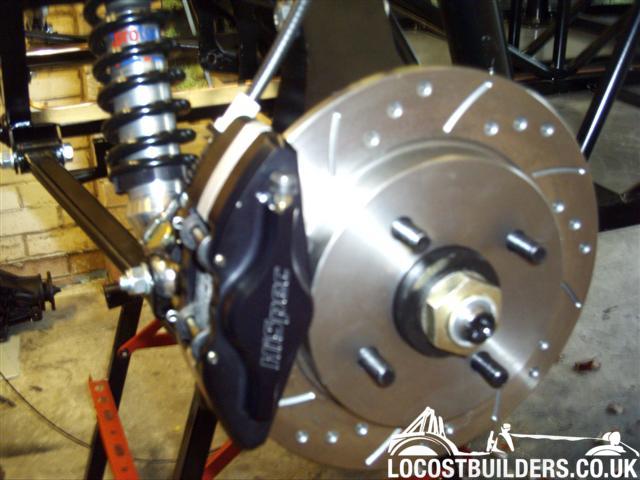

OK, got the brakes. Been a fairly painless excercise too!
Anyway to correct some posts on here, true to form I had a little look inside the rear caliper.
I can confirm that the handbrake does NOT work hydraulically, the handbrake arm moves a cam that operates the piston.
So there really shouldnt be any SVA issues at all.
Ian
