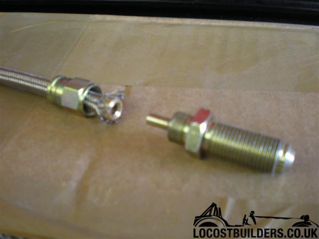

Putting on braided brake ends?
Is this the correct way, or should the braiding be cut back and not overlap the olive?
Thanks,
Pat...
Hellfire
| posted on 31/3/07 at 08:11 AM |
The braid needs to go up the front angle of the olive only.
When connected up properly it traps the braid and squeezes the olive down (and up) to the needle tube on the connector. Our's are like
this...

I know it doesn't help you, Pat but tbh I don't know. I'm going to have mine made up by a local air/hydraulics company.
You might be able to help me though.
The threaded male end in your picture - is that the caliper end or the inboard end to fit onto the copper pipe? (Just trying to establish what ends I
need to connect to both)
Andy.

Avoneer
| posted on 31/3/07 at 02:00 PM |
According to the PDF, I've done it right.
Just cut the hose square.
Push the olive inside the braid and onto the inner firmly.
Tighten up the outer.
That it???
All seems to easy.
Pat...

Avoneer
| posted on 1/4/07 at 04:52 PM |
Hi Andy,
That's the end that bolts onto the side panel and then the copper pipe bolts onto it inside the car.
The other ends are banjo's as I'm using HiSpec 4 pots and that's all they'd take.
