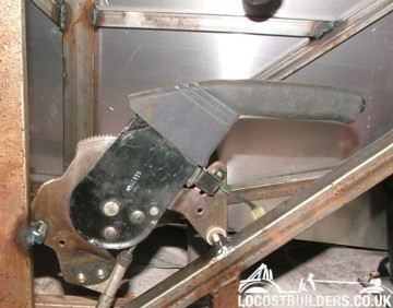

russbost
posted on 4/4/07 at 12:55 PM Reply With Quote
Here we are:-
[img]http://[/img]

FlansS14
posted on 4/4/07 at 02:07 PM Reply With Quote
Originally posted by coozer
Gear stick where the handbrake is? Thats a bit extreme is it not? changing gear with your elbow??
Not quite that far back if i put the handbrake in the std place the button would be 2" past the centre line of the gear stick.
Plus i want a straight up short shift gear lever not a dog leg one like some car's i've seen
Thanks for the pics i think ill get the gringer out at the weekend
