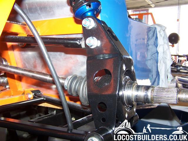

Also, the splines on my old driveshafts do not fit into the new Freelander Diff (I had a Ford Diff before). Do I need new driveshafts, or can I just change the spline ends? If so, who is recommended for the parts?

you need conversion shafts to take freelander inners and sierra outers, just had some done through mac#1.
IIRC one end has 22 splines and the other 21
