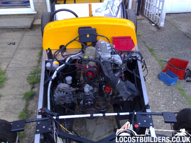

jollygreengiant
| posted on 10/7/07 at 07:56 PM |
Mine looked a bit like that when I started.
Feb 05
this it now
if I can get a good run this week then I might be posting to youtube a video of the first firing of the engine shortly (about a week but no
promises)
Yours is looking good. Keep it going.
Enjoy.

t.j.
| posted on 11/7/07 at 07:41 AM |
Mine is not bigger than the avon
If ment the pictures off jollygreengiant
then you're right. Probably made for RV8?
It looks if there's enough space for another engine. weight distribution is better, So I wouldn't bother.
Grtz
[Edited on 11/7/07 by t.j.]
