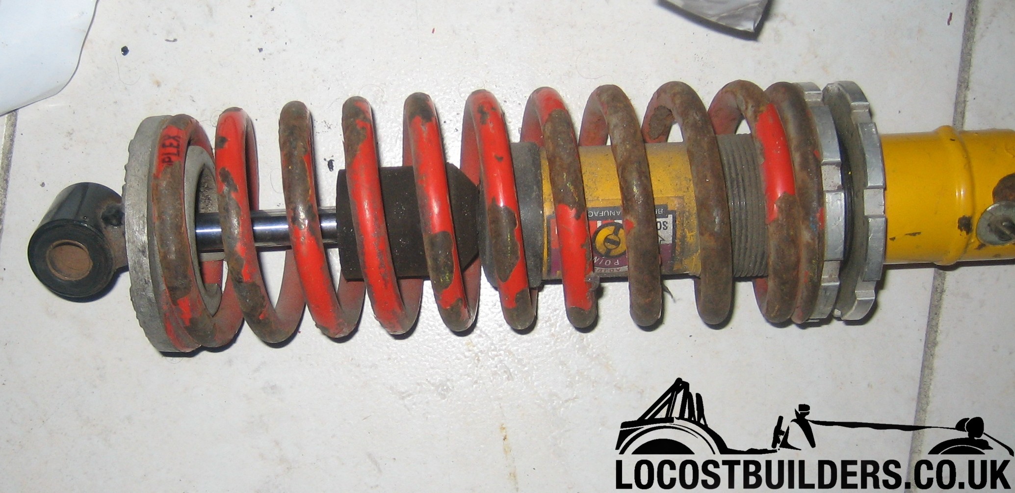

Hi!
Can anyone tell me by the picture and knowing that the section of the spring is 0,35" in diameter de lbs of this spring.

293 lbs/inch
if the 0.35" is right
and they're 1.9" units
& my calculation is right....
Bob
posted on 6/8/07 at 09:36 AM Reply With Quote
You need more measurements
Try here .You could take the spring out and look on the flat seating section as it is sometimes stamped on there.

If you have a pillar drill you could always use the old bathroom scales technique.

yep, you need to test them, you can't calculate with any accuracy at all for various reasons

use the old bathroom scales technique???
