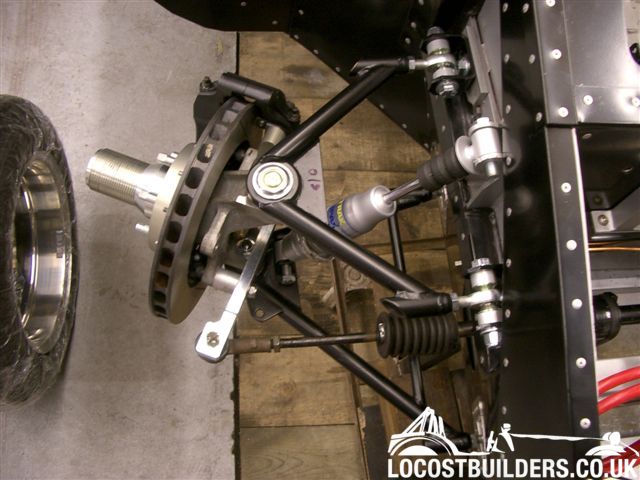

Light steering, any advice on geo changes?
My mid engined spaceframe car has steering that is rather on the light side, it's not a problem as such, but I feel a bit more weight would add
to the 'feel' of the car.
I'll dial in a few more degrees of castor, but was wondering about also shortening the steering arms.
The steering arms bolt onto the upright (to make life easier!). & the distance from balljoint to kingpin is about 150mm
Also I feel the ackerman is very wrong & whilst in doesn't seem to be a problem it would be nice to improve it.
Does anyone have any advice or opinions?

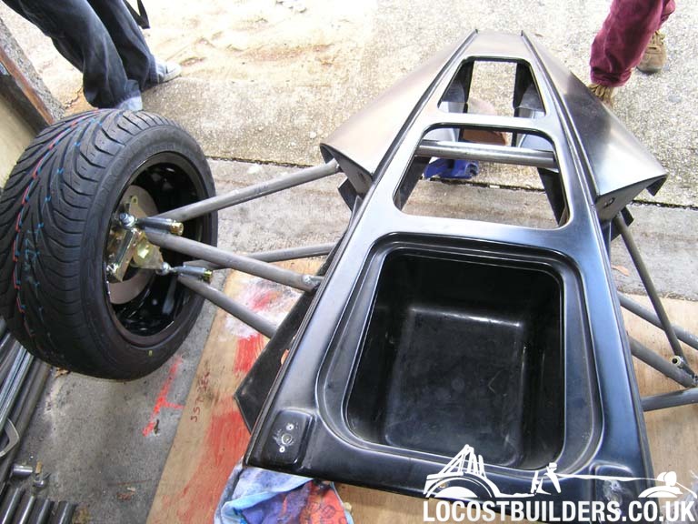

I did take a look at your steering arms on your hub and they do look a bit long.
My homebuilt jobies are only about 120mm from the upright centres.
You may have to move your rack as well.
Your picture:
My front end:
Wingnut
| posted on 12/11/07 at 03:14 PM |
Gents,
thx for the replies,
Hampshe, weight distribution is 43% frnt 57% rear. Unfortunately it's too late in the build to be moving stiff around in the chassis, but thx
for making me aware of the problem.
Nitram38, thx for taking the time to post the pictures. i hope I can shorten the steering arms without moving the rack!
Presumably as long as the arms don't foul the rack at any point it won't be necessary to move it??

Steering arms & ackerman
The steering arms look long but if you shorten the steering arms you will end up in an anti-ackerman situation even if you move the hole for the outer
track rod ends as far out as possible.
As it dosen't look possible to move the steering rack back to gain a quasi ackerman effect the only way open would be to move both top and
bottom ball joints forward (eg effectively increase the wheelbase) in addition to the ammount require to add more caster.
How much ackerman you need depends on what you use the car for but even if you intend to use the car exclusively for track days a percentage of
ackerman helps the turn in to slow speed corners.
