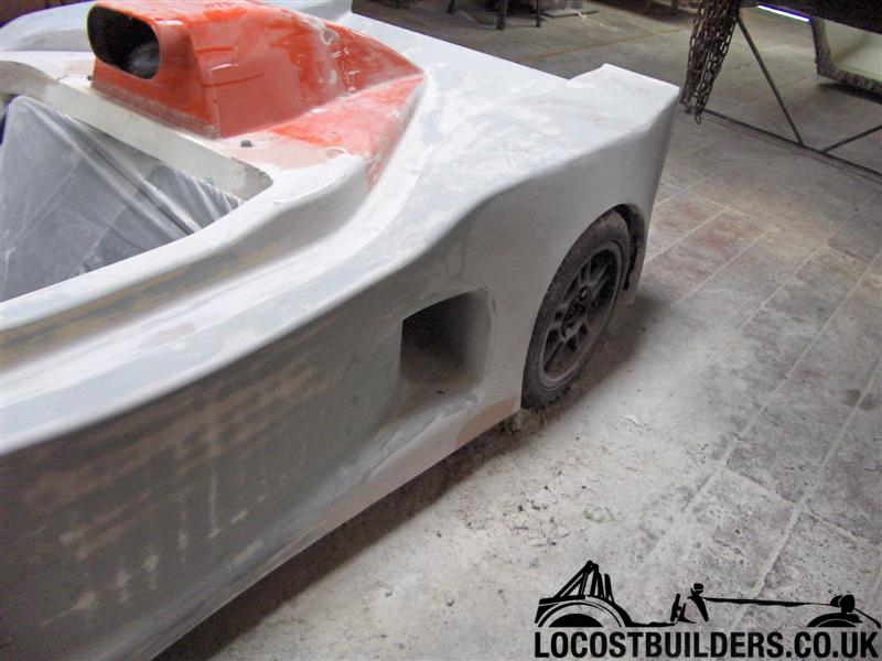

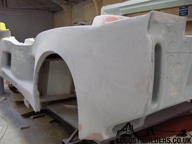

the car is a middy and it seems that the likes of radicals, lotus, etc. all have a larger rear wheel.
Iam only looking into the larger rear wheel for a cosmetic look of the car as the rear arch is such it make my 15" look small and out of
proportion.
But I would like to have the option of running a 17" at the rear if it was not to cause handling/ride
problems..JPG)
