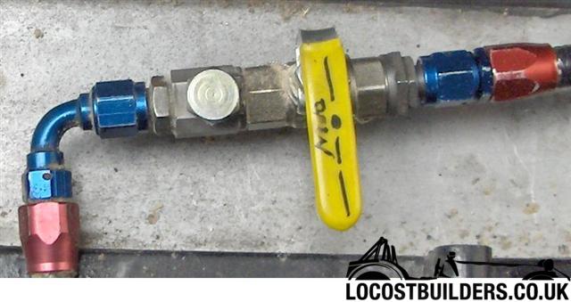

Can anyone tell me the size of the unions in the pic or a methods how to check the sizes?

There is a list of spanner sizes used for different size unions somewhere on the web, probably in the goodridge catalog.
You could always remove the unions and check the thread size.

http://www.speedflow.co.uk/help10.htm
http://www.kurthydraulics.com/threads.php ,as a guide 6 AN =14mm ish or 9/16, the nut size or spanner size is 11/16 or 18mm ,hope this helps ,someone
correct me if ime wrong

look like -6 to me.

-06 has an I.D of 8.7mm & has 9/16 x 18 thread (ie 9/16 is the O.D of the thread)
-08 has an I.D of 11.1mm & has 3/4 x 16 thread
HTH - I don't stock these unions/hoses but can get them in - I believe cheaper than you'll get them anywhere else
