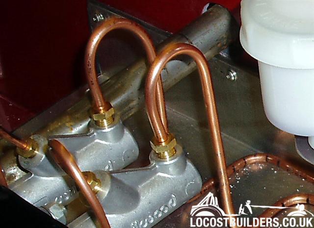

I bend brake lines with my hands. To get a nice even curve, I draw the radius on a piece of wood or card and bend the tube to match it. That way you
can get several bends the same.

I have had to use hand made bends to get sharp curves Eg, from the master cylinder.
