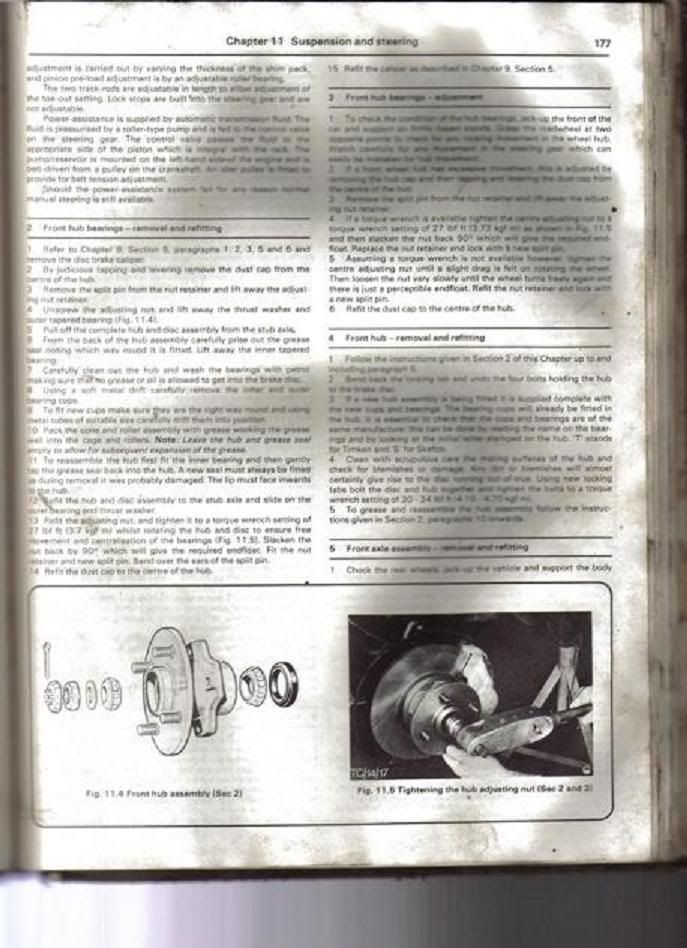

robinj66
posted on 6/2/08 at 06:19 PM Reply With Quote
Hope this helps
[img][/img]
bassett
posted on 7/2/08 at 08:33 AM Reply With Quote
Thanks robinj66 that was just what i was looking for, nice to be sure how everything goes together
