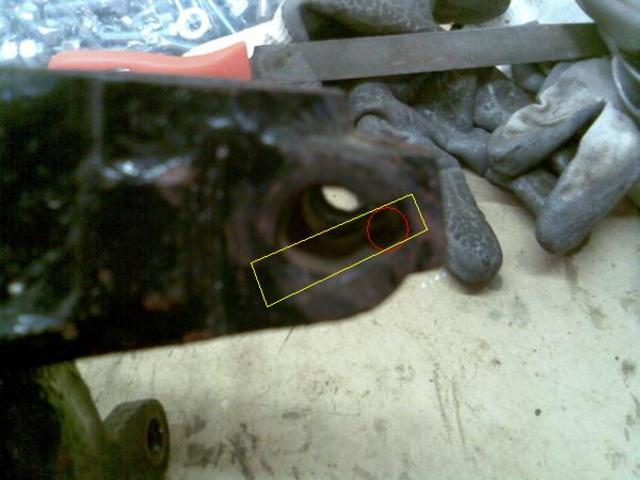

Hi
Whilst taking apart and putting back together my part built Indy i found that someone has drilled an odd hole in one of the uprights next to the pinch bolt that hold in the mushroom adapter.
Is is ruined?

That’s a lovely clear picture of those gloves
Why can't you just grind the surface back a bit till its level again? Loads off metal there, though difficult to say just how deep that is from the front

Yes, I did well there! The gloves are the most in focus object I've ever captured with my phone camera. :-)
The hole goes all the way through that part of the casting (i.e. the un-threaded side that clamps the mushroom).

yeek! I thought the hole was the bit in yellow! Not the one in red that’s weird, why on earth would someone do that??
hmm not sure now, I wouldn't use it. I'd use the premise that if an MOT tester saw that he would fail that part, end of story. Rescued attachment Image0653.JPG

I can only assume someone was trying to free a seized bolt?
Thanks, I thought as much.

Personally i wouldn't worry about it. Will it still pinch the mushroom and have a humungous safety factor due to it being a massive lump of over-engineered-for-purpose production car? Yes.
But then if you're personally not confident, there's nothing worse than driving around with the niggling doubt that your suspension wont stay in one piece.

Tend to agree with Liam, but you need to be happy with it...
