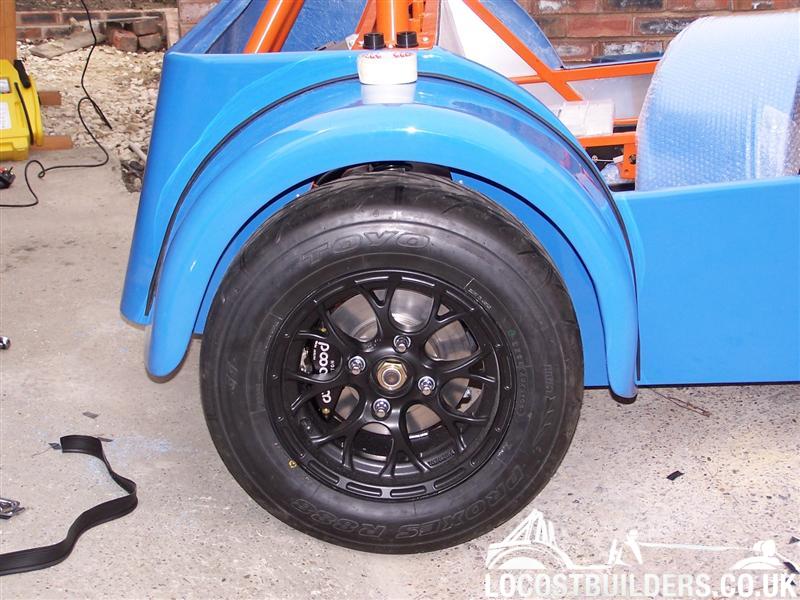

bigrich
| posted on 30/3/08 at 09:33 PM |
got wilwood front and rear under 13's, fronts are the sierra kit using 257mm solid discs and powerlight calipers
rears are fiesta front solids with wilwood h/b calipers but are not easy to get clearence with due to the design of the h/b mech. i have these under
13x7 et 30 compomotive cxr's
