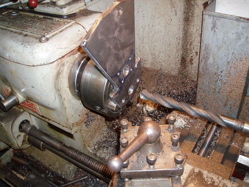

How do you cut a 40 mm hole in the front lower bones?
Answer..Very carefully
http://i129.photobucket.com/albums/p212/muddypaws4x4/locost107.jpg
Took me all day to make the plates
and god knows how many cutting discs.
finaly got them done
http://i129.photobucket.com/albums/p212/muddypaws4x4/locost111.jpg
Only last night to find out I could have bought them for about £8 from 3GE
bu***r

I chain drilled mine and filed them by hand
fatfranky
posted on 17/5/08 at 08:53 AM Reply With Quote
For what it's worth I have a copy of the Boxford manual and it recommends drilling large items (that are too long to fit in your chuck) the other way round. i.e. with the drill bit or cutter in the chuck and they supplied a fixture that fitted into the tailstock that you could clamp the work to, but i dare say that you could make up a suitable fixture if required

chain drill.... easy.
Wait a minute, holy crap, how thick is that metal plate? 10mm? Only needs to be 3-5mm!
Or is it an optical illusion?
liam.mccaffrey
posted on 17/5/08 at 08:08 PM Reply With Quote
I reckon they're tack welded together

Yep thats how I did mine. Two bits of 5mm plate tacked together as one .
Hard work but a matching pair
dogwood
posted on 18/5/08 at 03:41 PM Reply With Quote
Yup spot on, tack welded together.
Mind you should have seen the lathe wobble when I first started it up.
Full speed
had to do it at about 100rpm
Still frightning though.
