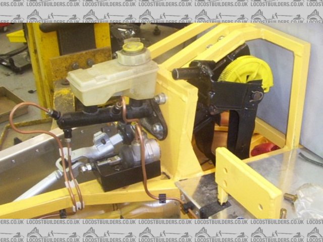

Mark Allanson
posted on 18/5/08 at 02:31 PM Reply With Quote
If you use the girling sierra setup, you can just remove the servo and the pin will fit directly into the master cylinder instead of the servo. No bias valve is needed if you have M16 at the front and drums at the back. Rescued attachment BrakePedals&Cylinder.JPG
