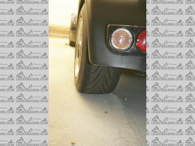

ChrisGamlin
| posted on 23/5/08 at 09:20 PM |
Ive got 205/60-13s Yoko 48s on a 7.5" rim on the back of my R1 Locost and they're fine, but I'd check with the supplier to check the
tyres you chose are OK on an 8" rim because the V70s are lower profile so won't accomodate such a variation in rim width. The advantage of
having a comparatively wide rim with a high profile tyre is that it keeps the tyre more stable. With a 6" rim, the same tyres would roll its
outside edge on track but with the 7.5" rim they're a lot more stable so wear more evenly.
  Rear Wheel
With an R1 I wouldnt go any higher than 205 though personally, with 185's on the front. Ive driven with 205's on the front and they
aren't as sharp turning in as with 185s on, so Id be looking for some narrower rims TBH.
[Edited on 23/5/08 by ChrisGamlin]

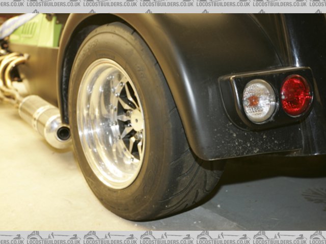

RichieW
| posted on 23/5/08 at 09:22 PM |
Ears motorsport do them too.(215 50 13) They are listed on their website at least. I've bought a set of 8x13s for the back of my car. I like the
deep dish look. Fronts are going to be a bit more sensible. I've gone with 6 inch rims
http://www.ears.co.uk
[Edited on 23/5/08 by RichieW]
