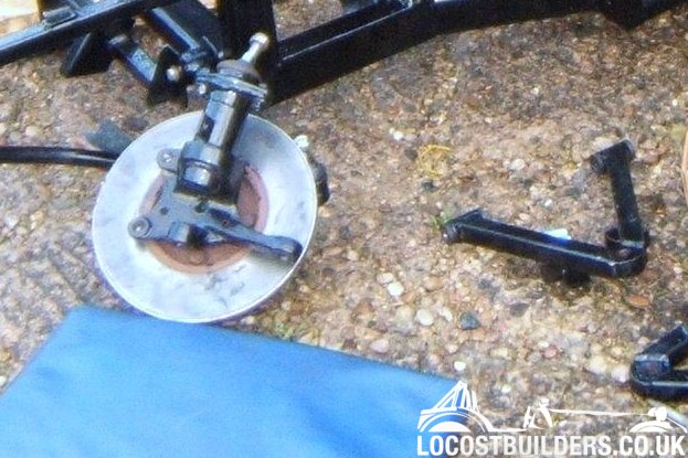

bimbleuk
| posted on 26/5/08 at 06:59 AM |
Another example of a Capri uprights on a Striker. Just fitted to mine to replace Sierra uprights which are much heavier and basically crap for
handling.
  Capri uprights
