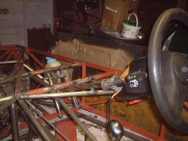

how have people mounted there steering column?
i'm trying to mount my steering column and i'm looking for the easiest but safest way of mounting it
if anyone has any photos they could show me i'd be grateful

CaptainJosh
| posted on 13/6/08 at 10:18 PM |
This is how I did mine:

mark chandler
| posted on 13/6/08 at 10:21 PM |
Another local builder...
here's mine, welded nuts in the ends of the tubes so it bolts in.

DavidM
| posted on 13/6/08 at 10:55 PM |
Mine:

big_wasa
| posted on 14/6/08 at 06:22 AM |
mine
Mark Allanson
| posted on 14/6/08 at 08:03 AM |
This setup passed its 4th MOT on wednesday
procomp
| posted on 14/6/08 at 08:12 AM |
Hi how ever you do it it is a good idea to try and incorporate some variance / adjustment for the height. Very rarely dose a wheel that has been
placed in situ in the workshop feel absolutely right when you start driving the car on the road.

speedyxjs
| posted on 14/6/08 at 08:21 AM |
Mark - Is your column just supported by cable ties?
Mark Allanson
| posted on 14/6/08 at 08:22 AM |
Cheers Matt
What do you think the cable ties are for?
Seriously. the column has about 2" vertical adjustment within the frame
