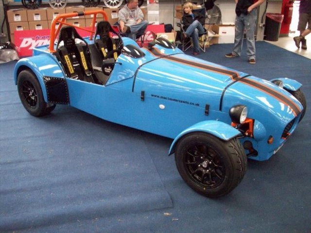

bigrich
posted on 28/6/08 at 10:34 PM Reply With Quote
13's will go over the front discs, but rear discs can be troublesome with certain types of rim. Compomotive CXR's are ok as are the new 13 inch pro race 1.2's.
I now have these on my car over wilwood 4 pots front and rear Rescued attachment newark 08.jpg
black.viper
posted on 29/6/08 at 09:55 AM Reply With Quote
Thx for advice! Your car is very nice and wheels looks like perfect.
But I try found "new 13 inch pro race 1.2's" rims - and under this name are made only Team dynamics and they are made smallest rims 14" not 13" - pls, where did you bought it and if you know weight this rims - becouse 14" have 5,7kg and it is too much.
Pls, do you everybody know what is weight Catarham 13" rims (from them shop for £99)?
Or exist some light cheap 13" rims around £100 with weight under 5kg (better under 4,5kg) - except Superlite (this are over £180)?
Im building Tiger Cat E1 Duratec engine
