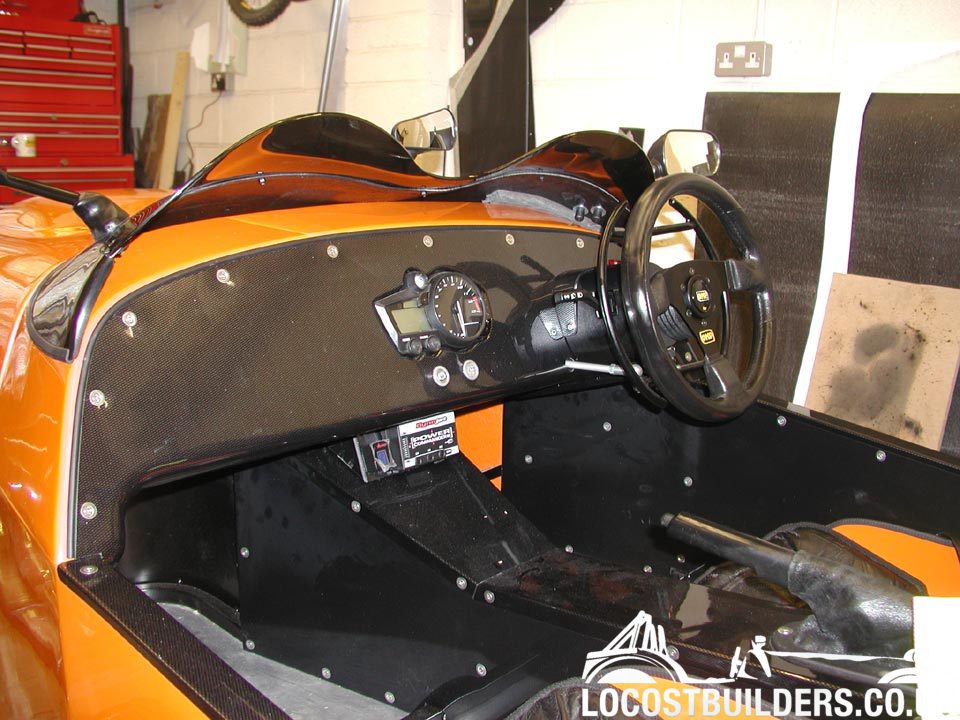

I did my interior with abs,used 3-4 mm 0n the back panel and the tunnel.

desyboy
| posted on 22/1/07 at 03:59 PM |
abs
complete interior in abs.

| posted on 22/1/07 at 06:15 PM |
That looks ace. How much per sheet and what size etc. ?

desyboy
| posted on 22/1/07 at 09:48 PM |
£15 per 6x2 sheet plus p&p
sorry i got it wrong its about 5ft x 2ft.
