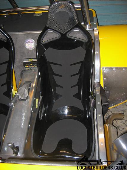

Another option which i have just seen is to stick padding onto the GRP MK ones....where could I get this?
I like how Hellfire has done his:
http://www.locostbuilders.co.uk/upload/Ickle%20seat.JPG
If Hellfire reads this, where did you get the padding from mate or did you cut it yourself?
Thanks,
Dan

Hellfire
| posted on 22/12/08 at 05:02 PM |
Thanks,
Dan
Dan, I sourced the adhesive foam from a company which I can never remember the name of. I've got details at work, so I'll post them up
tomorrow.
We designed and cut the pattern ourselves.
Phil

| posted on 22/12/08 at 09:01 PM |
Ive sat in the Cobra seats and the MK fibreglass ones Stick with the fiberglass ones and get some padding as Hellfire have done. The Cobra ones are
really snug Im 12 stone and theres not much room for movement you feel crippled after a coule of hours in one.
