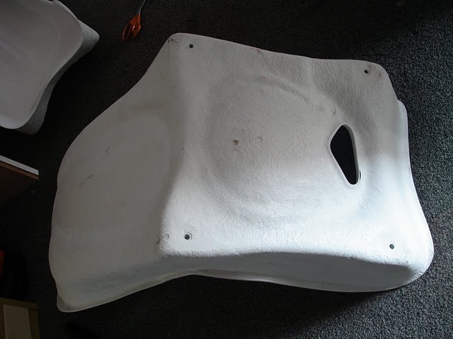

| posted on 19/2/10 at 06:26 PM |
Here's a picture of the bottom, of a white Lowside seat.
  Base
Hope this helps
Ed and Emma
TritonRaceSeats
| posted on 19/2/10 at 06:31 PM |
awesome, thanks everyone! a little way off buying any seats at the minute, but i'll have a good think
