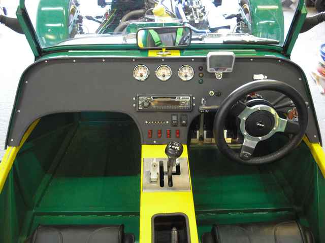

Yup Smudge88 (Grant) on here has done it
He's currently somewhere warm and sunning himself at the moment but found this in his photo archive
  Dash area
Note the groovy lock mech as well so it can be locked into or out of reverse!
Needed a bit of fettling for radiuses but passed SVA at S/Hampton (notoriously strict centre)

That looks great.
So, i might be better off making a gate that would replace the gaiter after IVA?

| posted on 14/8/10 at 02:33 PM |
I got used to mine very quickly, passed SVA ok, so would assume IVA would be ok too.
Reverse is quite heavily sprung, so accidents don't happen
Oh and it hides the remote assembly nicely
[Edited on 14/8/10 by Marcus]
