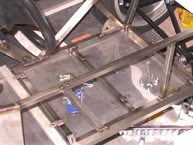

| posted on 26/7/04 at 12:02 AM |
Similar solution to avoid drilling the floor, cross members and lugs to bolt to cobra seat runners (back ones are a bugger to get at, with seats in
and panelling in place)
Front crossmember welded in higher than rear, to tilt the seat back - much more comfortable.
