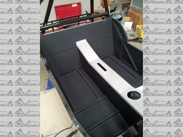

| posted on 21/11/12 at 09:56 AM |
I used Horse Box lining, a resin bonded material that looks like short piled carpet. From ebay, about £20 and was enough to do the entire
cockpit, including the back panel.

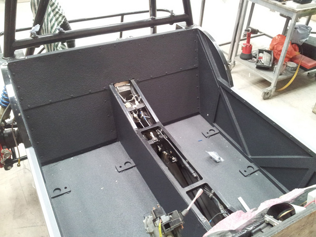

Hi, somebody has already mentioned truck bed liner. Mine is a spray in truck bed liner finish, I think it looks awesome, hard wearing and completely
waterproof. There are loads of colours available as well.
It was just masked and sprayed straight in after a light rub to key the powdercoat.

| posted on 22/11/12 at 02:06 PM |
The liner I have on there is Line-X, we have it in house where I work and have loads of our products coated in it to protect them. It is very hard
wearing, I have seen some of our products that have been left out in the elements for months on end and they appear as good as new. It adds a great
deal of strength and rigidity as well as being watertight. (so I still need a couple of drain holes in the bottom of my car to stop it becoming a
paddling pool)
http://www.linexnottingham.co.uk/
http://www.aigis.co.uk/line-x
Those addresses are the Line-X we use and what we use it for where I work. It is used on loads of our products to protect the blast absorbing TABRE
material we use.
It is sprayed using specialist equipment so it is not a DIY job sadly.
Spud1985
| posted on 26/11/12 at 08:01 PM |
That's the stuff I just bought to do my interior while the car is off the road for winter.
Did you do the floor in one whole piece, i.e. mould it over the chassis rails??

Matt_C
| posted on 27/11/12 at 12:23 AM |
All the Line-X branches are franchises so I can only talk for the Nottingham Line-X business (which is actually based in Derby now), I think it is
roughly £40 a square meter, sprayed at 2/3mm thick.
If you want an accurate quote for it to be sprayed talk to Simon on the number on the Line-X link above. If you are happy doing a little work and
offer to mask it up and key in the powdercoat in the warehouse sure he will give you a better price than if he has to do it. Would only take 5 minutes
to spray (and completely dries within 1 minute so it can be driven away straight after) so you would save yourself a bit on labour costs doing the
prep yourself.
I did all the prep and masking for mine. In the photos I have posted above, under the line-X I also glued 10mm thick wooden boards against the inside
of the SS side panels and caulked all the edges for a nice radius on everything. It makes the side panels feel a lot thicker and more solid.
Mates car done in a dark grey.
