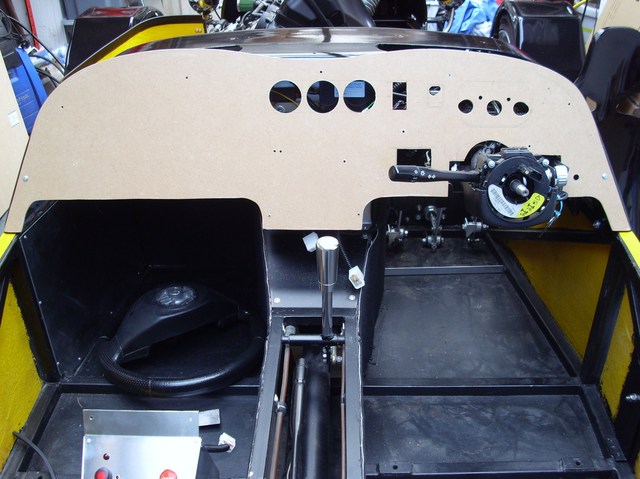

I built the dash up by laminating with layers of MDF. It is surprisingly light.
Have you sealed it? I would be worried about moisture with MDF, the stuff is like a sponge!

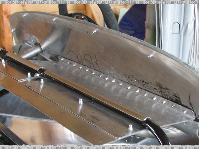

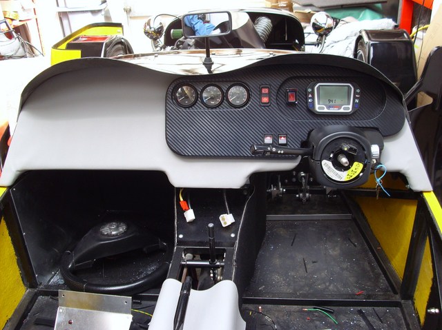

| posted on 21/11/13 at 11:18 AM |
I used aluminium covered with camping mat foam and vinyl. Bottom edges were bent over a bar to give the correct radius. Underside panel riveted to
front keeps it sturdy. Not in the same league as carbon fibre but a light solution.
