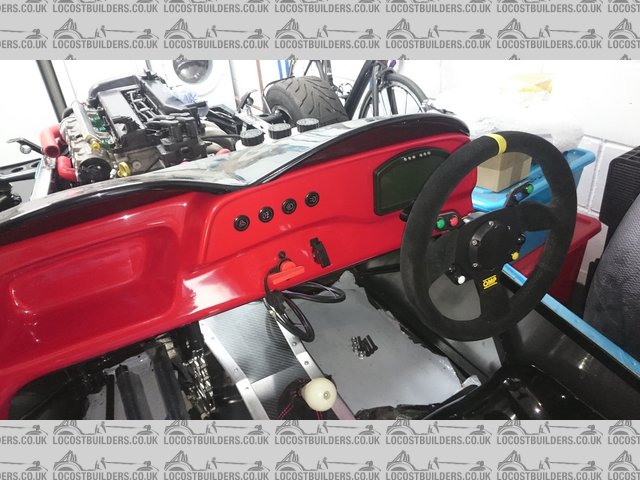

All the buttons I need whilst normal driving are on the steering wheel, don't have to take my hands off the wheel other than to change gear The connections run through a quick release fitting (with built in Lemo plug/socket) and come out under the dash via a curly cable. I have a slip ring from ebay that cost about £10 to replace the curly cable next time I am working in that area of the car but currently it works so no rush to change it really...just a slip ring will look neater in an area you can't see but I KNOW its there so will change it one day
The less important ones are on the dash but positioned so I can reach them when fully strapped in. I ditched the bulky Sierra steering column outer and saved a lot of weight at the same time so don't have anything to mount stalks on anyway
Dash layout
Dash layout
