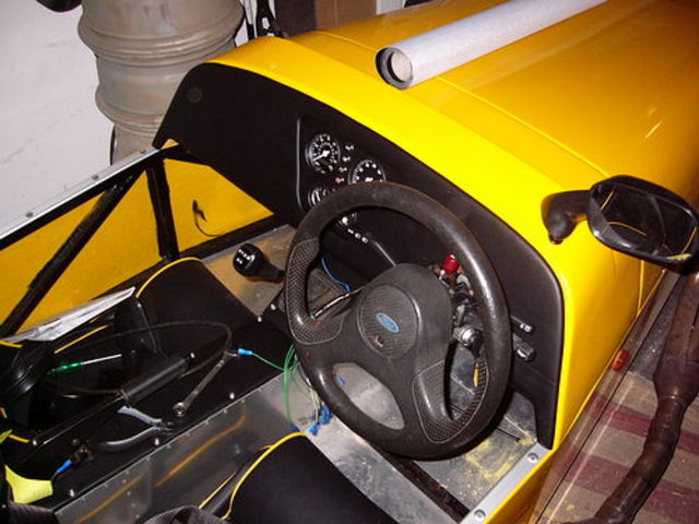

Finished my dashboard - comments please
Well after this thread...
http://www.locostbuilders.co.uk/viewthread.php?tid=49187
I finally got my thumb out of my arse and got on with making my own dashboard.
Thanks in particular to "Zetec" who offered some good advice and pointers on how to tackle it.
Here are the results, which I'm quite pleased with - your comments good or bad are welcomed

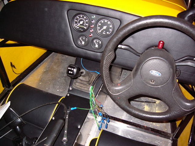

| posted on 17/8/06 at 08:02 AM |
and another...
oops...
| posted on 17/8/06 at 08:04 AM |
and finally...
Instruments from ETB
Lights from SVC
Vinyl and spray glue from Woolies Plywood from B&Q

| posted on 17/8/06 at 08:46 AM |
Agreed - some excellent craftmanship there!
I loved getting my dash finished and in - just seemed like a major step forward
If you believe you're not crazy, whilst everybody is telling you, you are - then they are definitely wrong!
| posted on 17/8/06 at 08:48 AM |
Hi Mark - thanks for your feedback!
Yes, the flat bottom is due to the position of the gearstick, but I may make another panel that sits vertically between the bottom of the dash and top
of the tunnel.
All the wiring is completely hidden behind ally panelling under the dash, with the fuse box and relays mounted above the tunnel out the way of knees
and SVA balls etc, so should be OK.
The bottom edge is made from 2 x 18mm quadrant strips of wood glued together then glued to the dash panel. The 3mm foam padding and vinyl covering
means the finished dash has a padded 20mm rad on the bottom edge - should keep Mr SVA happy
Muzchap - definately a big step and I did have to sit in the car, with the harnesses on just to savour the moment

cryoman1965
| posted on 17/8/06 at 08:56 AM |
Very nice Nick. Puts mine to shame
You cant be far away now.
How long till you get your sva. Do you think we could get a trip out this year?
Cheers Nige
mookaloid
| posted on 17/8/06 at 08:58 AM |
Very smart
How did you fasten it to the scuttle?
Mark
| posted on 17/8/06 at 09:18 AM |
Nige - looking to send off SVA paperwork in the next week or so. Hopefully we can catch the end of the summer for a couple of blats round the
hampshire countryside
Mark - it's not secured yet, but will be bolted to the scuttle with M6 dome head socket caps, same as the trimmed panels on the top of the
tunnel.
| posted on 17/8/06 at 09:34 AM |
The same method Zetec used and described.
I kind of like the bolted look though and will be using top quality stainless fastners so should stay looking good

zetec7
| posted on 17/8/06 at 05:14 PM |
As I am something of a purist (no digital dash things for me, thank you), and old-fashioned (proper gauges have black faces, white numbers and white
needles, thank you very much!), I like your dash!!! It looks RIGHT. Now then, where did you get the gauges??? (I'm from the Great White
North, and guages like that are rare hereabouts...). Thanks...
quinnj3
| posted on 17/8/06 at 06:34 PM |
hi i think it looks smart, tidy, clear and functional. No glitery bits just a very nice clean job. Excellent

| posted on 18/8/06 at 07:59 AM |
Zetec 7 - the guages are from ETB Instruments and can be bought with a variety of coloured faces and
finishes. Not cheap, but not expensive when you see how well made they are either. Excellent customer service and support and very fast mail order
service.
HTH Nick
02GF74
| posted on 18/8/06 at 08:41 AM |
where's the fuel guage?
zetec
| posted on 18/8/06 at 02:56 PM |
Well done mate looks first class, will really finish the car off.
