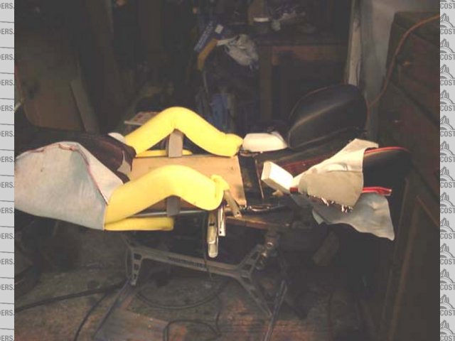

Well yesterday I went for a spin with the wife in the Viento. On the way home, I felt I was slumping in the seat, more and more. When I got home I
found there was some movement in the rear of the seat. Today I took the seat out and stripped off the covering to find that the frame had cracked at
two welds one on each side. The back had all but come away from the bottom section.
I am less that impressed by a seat that has the frame fail after just 1903 miles on the road. To me the fillet they welded in is not long enough or
in the right place as it failed at the end of the fillet, and right on the weld. I have no replaced it with a bigger support.
I could have returned the seat under guarantee. However, that means no seat for however long it takes Cobra to repair or send me a new one.
There are not going to be many more nice days, so I fixed it myself. I'm not angry, just a bit miffed by the build quality.

My brother-in-law had a set of cobra seats in his hot hatch.
He's not the smallest of chaps and his failed in exactly the same way

Yep, been there, seen that, done that, crap they are !

I had the same. I returned mine to Merlin Motorsport who got it replaced.
I spoke to Cobra and someone let slip that they are sometimes prone to early failure. They also said that for safety reasons the rear back rest should
follow the profile the rear bulkhead so that in a big rear impact the seat will be supported.
I make an effort not to put all my weight on the backrest when getting in and everything is fine now. I know the design is weak but they are comfy and
fit well.
