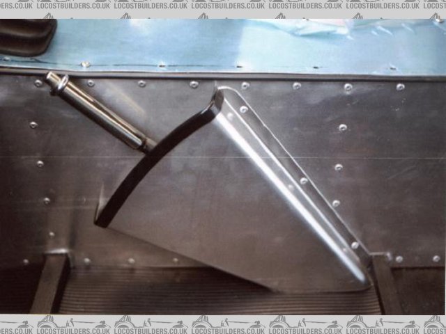

Surrey Dave
| posted on 17/11/06 at 10:03 AM |
MG Midget Lever / Marina cable

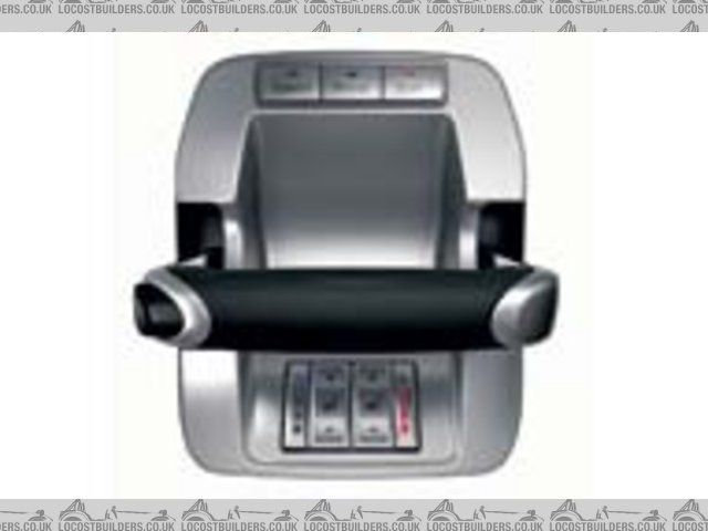

I've also been looking at the Megane handbrake as 'something different'. But how about the handbrake from the new Ford S-MAX? Looks
even better IMO.
  S-MAX handbrake
Don't know how easy one of these (or the Megane one) would be to fit to a seven, though.

mistergrumpy
| posted on 17/11/06 at 09:03 PM |
Is that mounted vertically or horizontally? Looks good.
Indymike
| posted on 18/11/06 at 03:40 PM |
I think it's mounted vertically. Does't look like there's much room for 'travel' though. But looks nice, I think.

| posted on 18/11/06 at 04:46 PM |
Does it push down and pull up like the scuttle mounted ones or rock backwards and forwards. If it pulls up it would be awkward from where you sit in a
sevenalike.
Indymike
| posted on 18/11/06 at 06:24 PM |
Not sure how it works, as I've only seen it in pictures. But looking at the slots where it goes into the tunnel, I'd say you push it
forwards to engage. Kind of like in an airplane when you want to take off!!

quote: Originally posted by Surrey Dave
Used this technique in mine though with a manta lever slightly rebent.
No problem at all with bashed elbows with it there.
Made a roller to go in the end of the lever on mine to eliminate the need foe a seperate "compensator" to equalise the two cables, then on
dismantling the Fiat 126's that I have at the mo, I have realised that they have a roller on the end of the lever as std..............about the
same 45mm diameter as the one I made too!
