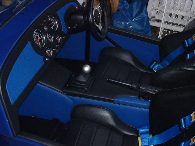

Hi David,
The top of my tranmission tunnel consists of two sheets of 16swg mild steel. One for the section over the gearbox, from bulkhead to gearstick and one
straight section from gearstick backwards. Mine do not go down the sides of the tranny tunnel at all.
I used two layers of thin foam padding (actually hobby foam for kids to make shapes out of!) and then covered the whole thing in leather-look
vinyl.
As far as fixing down is concerned i used riv-nuts and dome headed bolts (set screws). These go thorugh eyelets in the vinyl and then through the mild
steel. They become effectively countersunk as they compress the foam padding upon tightening.
HTH
Rich

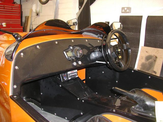

| posted on 14/2/07 at 08:57 PM |
Vinyl covered 8mm marine ply, edge routed 1/4 round, screwed to frame with c/sunk stainless M4s
Bob

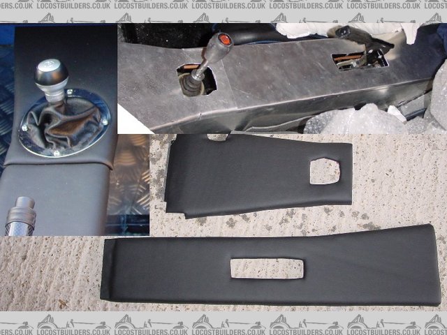

Humbug
| posted on 14/2/07 at 09:15 PM |
My tunnel top is 2 pieces of ali: 1 straight bit back from just behind gear lever, and 1 front bit. They are bent over the side (90 degrees) and
covered with foam and vinyl.
The rear piece is fixed with 2 self tappers at the very rear on the folded-down sides behind the seats. The front of the rear piece tucks under the
rear of the front piece (if that makes sense) and the front piece is held down by the self tappers through the gear lever trim ring.
Got me through SVA no probs
A cobbled-together pic here:

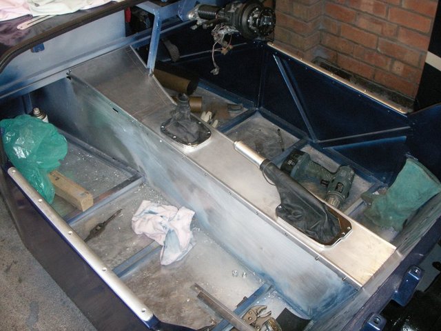

Mark Allanson
| posted on 14/2/07 at 09:20 PM |
a variation on a theme

PaulBuz
| posted on 14/2/07 at 09:36 PM |
Just used some ally with an extrusion to cover the edges
Paul

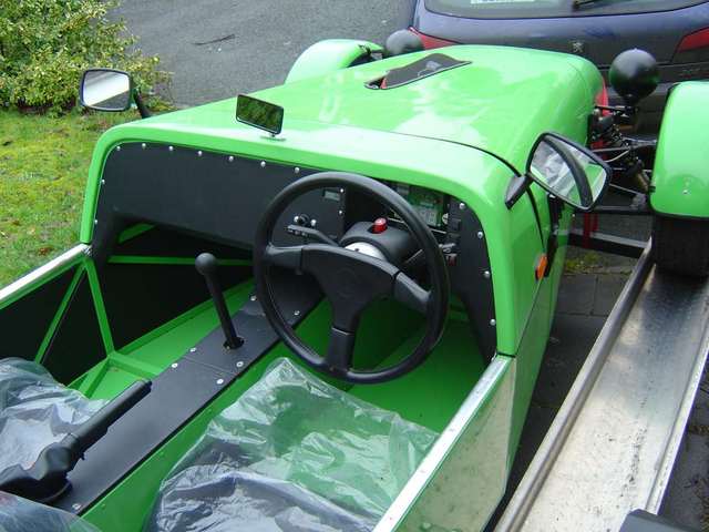

RazMan
| posted on 15/2/07 at 11:17 AM |
I used some anodised alloy step edging from B&Q

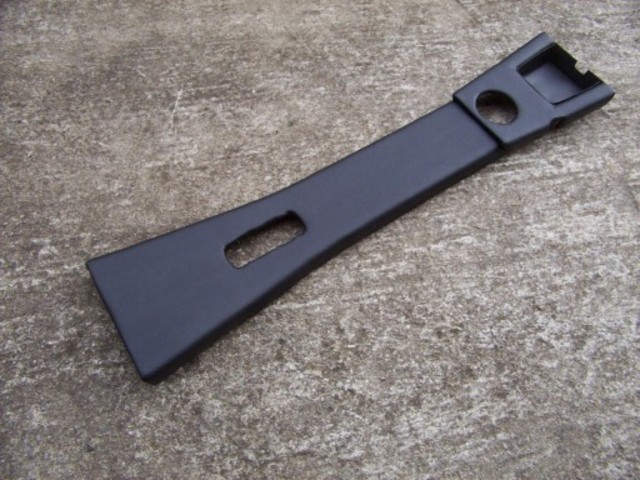

desyboy
| posted on 24/2/07 at 07:40 PM |
vac formed abs
  interior
