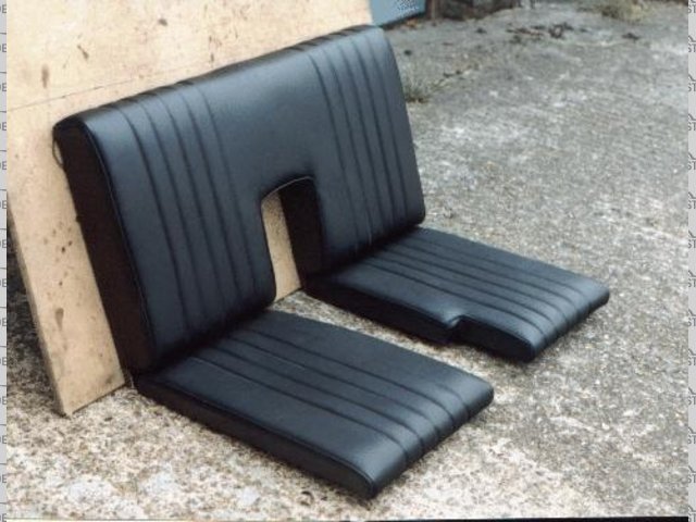

These where fitted like this for SVA ( seat belt height issues) then I repadded them after the test for more comfort.

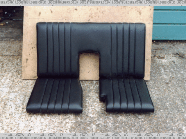

Seat Backs

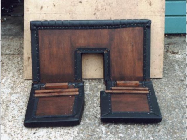

Last Pic!!
