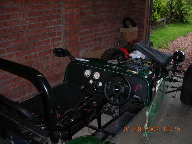

Interior pics
Got some of the interior finished last night.
dave1888
| posted on 2/9/07 at 11:42 AM |
And another, Zil need not reply to the interior carpeting
PaulBuz
| posted on 2/9/07 at 12:15 PM |
looking good
How have you radiused the bottom of the dash dave?
Paul
dave1888
| posted on 2/9/07 at 12:45 PM |
20mm radius using half round timber.
BenB
| posted on 2/9/07 at 01:05 PM |
Looks good. Are the edges of the dials and the edge of the switch plate SVA okay???? Just wondered....
dave1888
| posted on 2/9/07 at 04:59 PM |
The gauges are not sva compliant but i have recessed them into the dash so they sit below the surface, the dash is made from an old piece of laminate
flooring purchased from b&q for the pricely sum of £1 covered in vinyl no padding. The swith plate is thin alloy tiger spec so it should be ok.

Mountney 30cm from the bay
snapper
| posted on 11/9/07 at 05:39 PM |
What wing mirrors are they?

the dash looks very tidy with that layout
