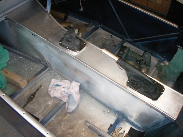

Been paneling the tunnel today but i need to SVA prof the edges of the tunnel. I really like the rough look of the tunnel as it's just want i
wanted but SVA man will blow his top! Dont want to cover with ugly cloth trim so what choices have i got? Need to make it so i can take it off after
sva.
[img][/img]
Many thanks locosters

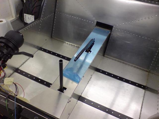

I have fitted a 'j' profile thats nice & rounded at the top.
Paul
