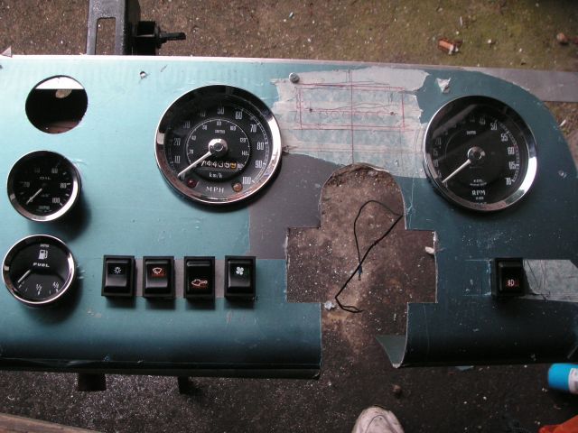

For the 100 mm Speedo and rev counter holes. I chain drilled and filed in aluminium. Slow, tedious but locost
Not sure how that would work with carbon fibre tho.
  dash 1
  dash 2
I'm keeping the Sierra indicator / dip stalk but not the offside stalk.
[Edited on 25/5/08 by Macbeast]
