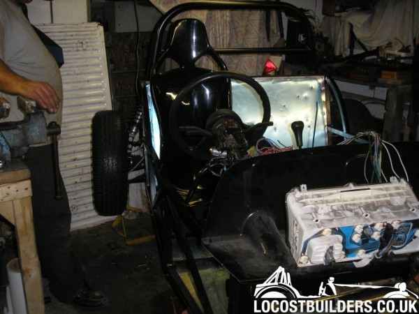

hi all i got a few hours in on the car today and i have done, the transsmisson tunnel panling, made my gear stick in to a quick shift, and mounted my
seat.
pictures below
tell me what you think
stuart
  transmession tunnel
  transmession tunnel 2
  Back
  seat
  seat mounts
  seat runners mount

Very nice
| posted on 28/5/08 at 07:00 PM |
Gear stick looks too long

Looking good, although the seats look very high, if you are using the standard harness locations, this will be an SVA fail.
The top belts should have a straight run to your shoulder from the mount and should not be supported by the seat, unless you can prove that the seat
is designed to take the force of the belt.
Otherwise, looks great.

Are you screwing the seats into something substantial? The box section, and the floor mounting, look pretty flimsy!?

nice - you're gonna have trouble changing gear with the gearstick under the seat liike that.
Ian
oh, if i put the seat lower down, i can not see over the car.
are triton seats designed to take the force of the belt??
stuart
Ian
i just went to have a look at my harness, and put them on the car, and sat in the seat and the harness goes up to go over my shoulders would that be
ok?
what page is it in the sva manual i will try and see if the it is in the free manual i have got offline.
chears
stuart
