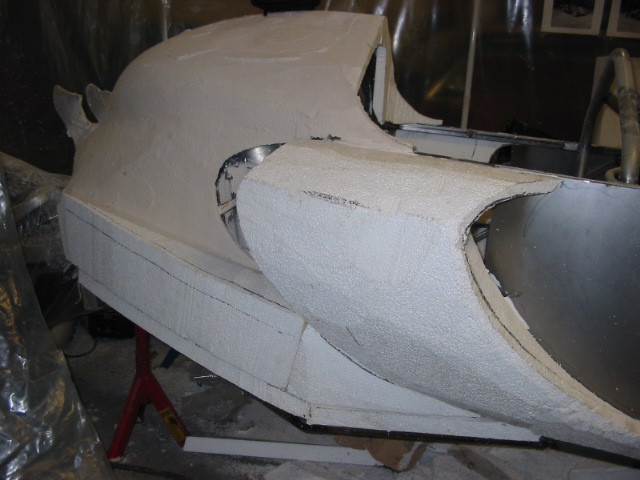

Here´s some pics. on my body work ..
The pics. are taken from 1,5mounth till for 3weeks ago..
Here I´m welding om a TEMPORARY steel plate- so I have a smoth side panel I can make a mould of.
Am I building a BOAT?????
It´s starts to form a nose
Air scoop.
Scoop outlet..
Exhaust..
[Edited on 26/11/04 by Micke Fredriksson]

I have sprayed the body plug with putty (filler) so I get a smother surface to work with. I use a Wall putty with water base. Very easy to form!!
There´s only one problem- I have to wait several hours before I can sand it.... If I use a 2K putty, the mold base plastic will melt... ..
