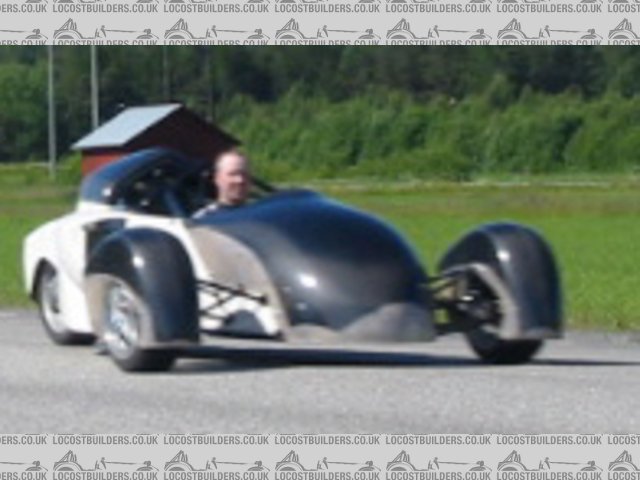

Unfortunate choice though.
The photographer could have picked a better spot, or is the shed on the back something to do with the noise level reduction.
OHH NO!!! You cought me!!
Yes I bought a 20m3 shed and mounted it on the trike to get a sound proof wood wall around the silencer.. I thought noone would notice it
Funny, I havent noticed the shed before
