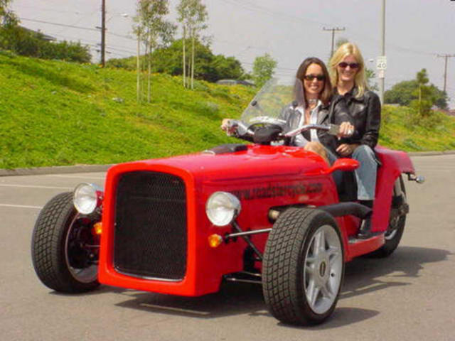

| posted on 24/4/07 at 07:37 AM |
Carcentric Reverse trike
I think your Idea is neat your just in the wrong place. The place to be for what you want to do and the help you need is a site called
reversetrikes.com There is a V8 trike similar without the fender flares. I have modified Ron Champion frame on a Honda Gold wing. You do need to have
a wider wheel track for the length you are looking at though for stability. 40 inches wont do the basic formula is two thirds the width, front wheel
track, to length.
Dont let the nay sayers stop ya. jus t join the right brotherhood.......yee ha better on three ....you can eamil me if you need other
info.....
| posted on 24/4/07 at 10:07 AM |
I can just imagine a CX500 trying to pull that lot round 0-60 if you're lucky? They weren't exactly blessed in the power department. I
like the two up front trike but it needs something more than 30 something hp. Here is another trike site to join.
