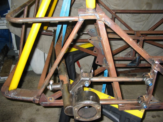

I have bought GTS rear end and am fitting it to a book chassis.
As you're using a sierra rear end the track will be a few inches wider than the escort axle, I think it fills the rear arches nicely.
You can fit either standard or wider front wishbones, your choice really. I am using standard as I already had them and do't think it'll
make much difference..
Ned.
  dedion_axle
  dedion axle2

My chassis is basically modded as per Darrens drawing, pics above
Ned.
