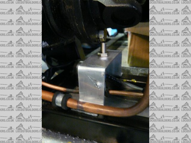

| posted on 20/10/17 at 08:47 AM |
This is mine on the Panther, works really well.
[img]
  Speedo Sensor
[/img]
http://www.triangleltd.com
Double R
| posted on 20/10/17 at 01:11 PM |
Thanks for the link, new sensor ordered this morning :thumbup:
The original bracket was a single angled strip of ally, I'll definitely follow the one in the photo, as I'd imagine it will be
significantly more stable.
Cheers all!
