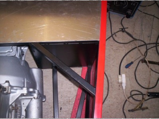

| posted on 24/5/06 at 05:56 PM |
Whilst it won't fail the sva, those tubes are fairly important for chassis stiffness, as they leave the engine bay as an open box. This was what
I did on my chassis in the same place:
PS this isn't quite finished at the front yet.

andyw7de
| posted on 24/5/06 at 08:57 PM |
missing brace
Here is a pic of my bay showing the missing braces. I think this shows that these should be fitted in order that the chassis performs as
designed.

| posted on 24/5/06 at 10:17 PM |
I would say that those braces ARE quite important to the overall stiffness of your car. Those braces are designed to replace the standard Locost
"R" tube which goes from the inboard corner of the footwell to meet tube "S" (IIRC) just above the offside rearmost suspension
mount.
Cymtriks (you know the FEA guy) stated several times that the removal of tube "R" was a bad thing although unavoidable if you want a V8 or
other wide engine. The best solution was "Y" braces like those shown above by DIY SI but having two 45 degree braces (one either side) was
much better than nothing at all.
My McSorley 7+4" chassis has the same 45 degree braces either side and I firmly believe that they add a great deal to the strength of my
chassis. You should be okay for SVA but I'd fit the braces as soon as possible and certainly before any spirited driving!
Here is a photo from a couple of years back:
