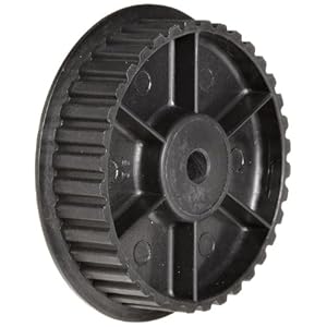

I cant see using tooth pulleys, meshed as gears, without a belt, its going to be other then hideous. A lot of tooth belts are less than 50% too as
well, meaning the pulley cannot mesh, as per the below image.
Lathe gears sounds a much better idea, although you can/could by off the shelf pulleys new for very reasonable prices, or as said, you could go with a
chain drive solution, or even belt drive, which my be less fussy on mesh, if you have the space to get something in which can handle the torque.
